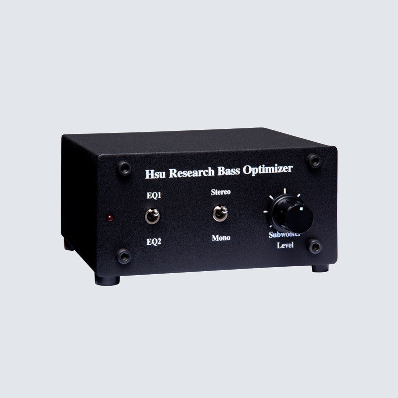

The Hsu Research Bass Optimizer is a small equalizer box that allows users to achieve a flat extended bass response from our TN series subwoofers while using their own power amplifiers. To power a TN series subwoofer, an amplifier must be rated at 200 watts at 4 ohms. You should have some sort of low pass crossover functionality in the receiver or preamp processor. Dobly Digital and DTS processors have such functionality. Otherwise, you will need the High End Crossover or a Hsu Amplifier which have low pass crossovers built in.

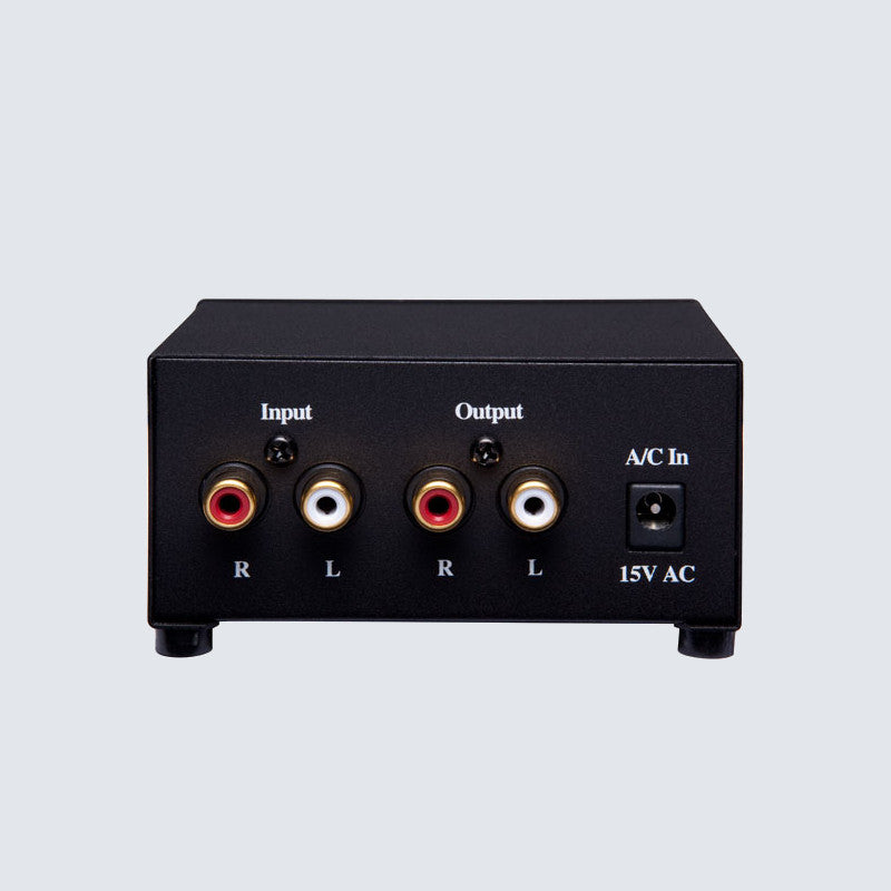

Setup is straight-forward. Most people take the line-level subwoofer signal from their Dolby or DTS processor and feed that into their Bass Optimizer. They then take the Bass Optimizer line-level output and run that to their external amplifier.

  • Level control for adjusting the subwoofer level.
  • Stereo/Mono bass selection.
  • Selectable Equalization (TN1220HO or 1225HO)
  • 12 dB per octave infrasonic filter. If the front switch is set to EQ 1, the infrasonic filter is at 15 Hz. When set to EQ 2, it is at 22 Hz.
